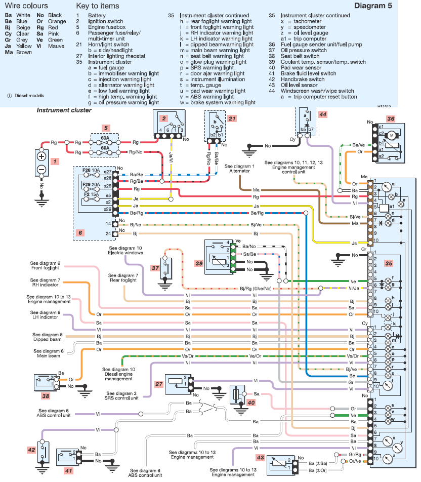

clio mk2.png (156.14 KiB) Viewed 3026 times
